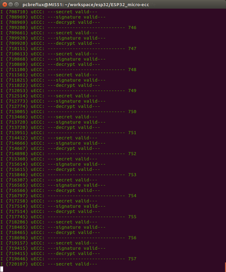

Sample using Elliptic curve cryptography with micro-ecc and ESP32 hardware enabled cryptography aes (256 bits, Counter Mode (CTR)) and sha (SHA-256) hash:
https://github.com/pcbreflux/espressif/ ... _micro-ecc
ESP32 Elliptic curve cryptography with micro-ecc, aes, sha example
- micro-ecc.png (172.6 KiB) Viewed 11325 times

Re: ESP32 Elliptic curve cryptography with micro-ecc, aes, sha example
Hi DL88AI88,
thanks. Coincidentally i published a new secure MQTT example on github yesterday.
With MQTT via SSL/TLS (also hardware encrypted) and Websocket -> testing my secured mosquitto servers on UBUNTU and Raspberian.
-> Part of my /etc/mosquitto/mosquitto.conf
ESP32 example:
https://github.com/pcbreflux/espressif/ ... mqtts_gpio
But i will try an example with "secure" bluetooth in the future.
